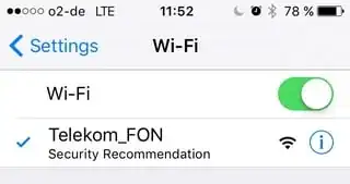

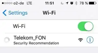

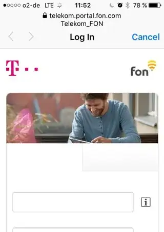

this hotspot first connects and then opens up automatically a login page:
1 Connecting
2 Connected
3 Login Page
How to configure the hotspot in a way that devices are automatically forwarded to http://localhost:80 on connecting.
