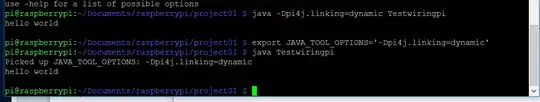

The first directive is to set the CLASSPATH environment variable by adding to the existing CLASSPATH the directory where the Pi4J library jar files are located. The second is to provide the necessary directive to java when running an application using Pi4J. screen shot showing application behavior with and without JAVA_TOOL_OPTION
