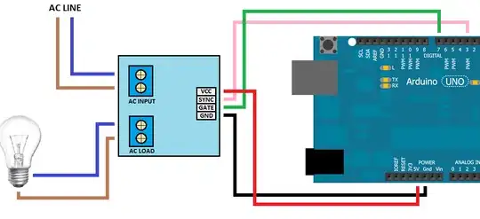

I have connected Module's VCC, GND and Gate pins to raspberry's +5, GND pin 18 respectively.
enter image description here (the wiring is actually done with a Raspberry Pi 3, ignore the Arduino board in the wiring diagram above)
