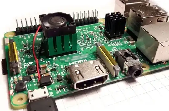

I have a RPI3 with a mini heatsink, like the following image:
RPI
Both heat sinks (14x14x11 mm and 9x9x12 mm) are made of aluminium and the fan is a SEPA MF15B-05 (15x15x5mm, 5V-0.06A) that is soldered to the printed circuit board (so it is permanent :P)
So the iddle temperature with Raspbian Lite, WIFI connection and SSH active connection is about ~37°C in a 25°C environment (measured with 2 different DHT11), as the image:
Temp
Here are the results for sysbench (The temp (vcgencmd measure_temp) commands were executed immediately after sysbench):

If I remove the fan and the heatsink, the normal temperature is between 45°C and 47°C, with the same clean Raspbian lite installation (default background processes) and a environment temperature of 25°C in a room with quiet air flow.

Number of threads: 4
Additional request validation enabled.
Doing CPU performance benchmark
Threads started!
pi@raspberrypi:~ $ temp
19-02-2017 16:57:22.717 temp=67.1'C
19-02-2017 16:57:25.064 temp=68.8'C
19-02-2017 16:57:46.095 temp=74.7'C
19-02-2017 16:57:55.097 temp=75.2'C
19-02-2017 16:58:06.956 temp=76.8'C
19-02-2017 16:58:13.016 temp=77.4'C
19-02-2017 16:58:25.937 temp=78.4'C
19-02-2017 16:58:35.897 temp=79.5'C
19-02-2017 16:58:51.417 temp=80.6'C
19-02-2017 16:59:32.226 temp=81.7'C
19-02-2017 16:59:49.787 temp=80.6'C
19-02-2017 17:00:31.352 temp=81.1'C
19-02-2017 17:00:42.532 temp=81.7'C
19-02-2017 17:02:46.227 temp=81.7'C
19-02-2017 17:03:22.253 temp=82.2'C
19-02-2017 17:04:37.505 temp=81.7'C
pi@raspberrypi:~ $ Done.
Maximum prime number checked in CPU test: 50000
Test execution summary:
    total time:                          500.6550s
    total number of events:              10000
    total time taken by event execution: 2002.3821
    per-request statistics:
         min:                                171.32ms
         avg:                                200.24ms
         max:                                460.88ms
         approx.  95 percentile:             224.74ms
Threads fairness:
    events (avg/stddev):           2500.0000/6.00
    execution time (avg/stddev):   500.5955/0.06
[1]+  Hecho                   sudo sysbench --num-threads=4 --validate=on --test=cpu --cpu-max-prime=50000 run
19-02-2017 17:05:45.548 temp=67.7'C
19-02-2017 17:05:51.425 temp=65.5'C
19-02-2017 17:06:28.859 temp=60.1'C
19-02-2017 17:06:51.751 temp=58.0'C
19-02-2017 17:07:02.178 temp=57.5'C
19-02-2017 17:07:39.439 temp=54.8'C
19-02-2017 17:07:56.307 temp=54.8'C
19-02-2017 17:08:17.866 temp=54.8'C
19-02-2017 17:08:32.100 temp=53.7'C
19-02-2017 17:09:17.898 temp=52.1'C
19-02-2017 17:10:02.736 temp=51.0'C
19-02-2017 17:10:40.158 temp=51.5'C
19-02-2017 17:14:35.286 temp=49.4'C
