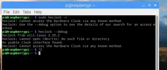

Tried the fix suggested on a fresh install of NOOBS v1.9.2 after sudo apt-get update and sudo apt-get dist-upgrade
Same issue remain.enter image description here
