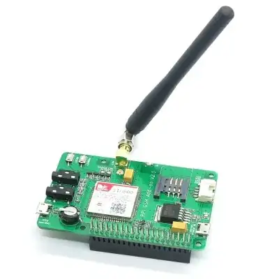

Assuming you are talking about one of these that looks like this you should go over this to test your device.
RPI SIM 800 GSM
From what I can see
  • This device communicates over serial port (USART) using board pins (8-TX, 10-RX) and supports the AT commands
  • When you connect this device to the PI, the required USART pins are connected to module and the rest of the pins are brought out so that you can connect another 'hat' on top.
  • Make sure to first disable the default console that takes control over the serial port on startup before trying to communicate with this device
  • You can use a serial terminal such as minicom to send and receive AT commands and responses and verify the device works as expected
  • Having worked with a similar device before (SIM 900A), I strongly recommend using a external power supply (2A+ capacity) via the micro-usb connector to power this hat as it requires quite a bit of power as quoted here
  • GSM works best with clear LOS to satellites (meaning doesnt work great indoors) you might need to go outside to check
If SIM800 will drop off while working, please connect a external at least 5V/2A power supply to this micro usb.
If this is not the device, share more details (a picture would be nice :) )
HTH
