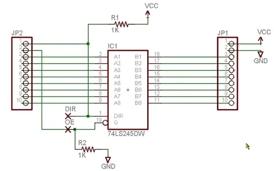

Or just buy a 74LS245 from Digi-Key or Mouser Electronics and connect it like this:
Low cost 5 V to 3.3 V converter
