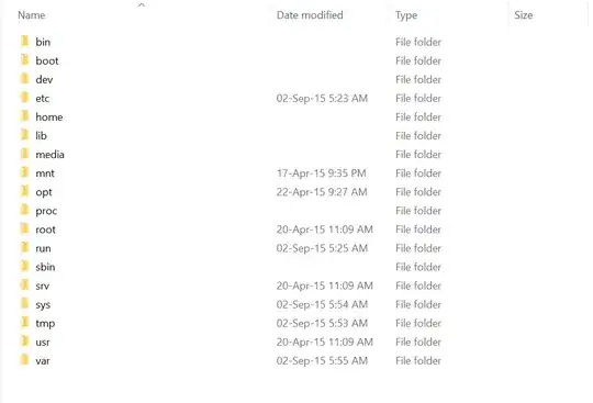

The problem is that the SD card looks like nothing the original backup I did:

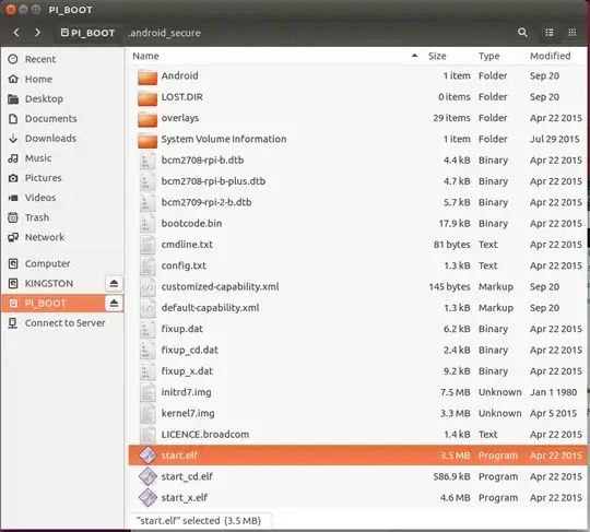

Instead, these are the files it now contains (as viewed from Ubuntu):
As you can see, Android has added some of its own files to it - and the Ubuntu structure appears to have disappeared. Am I still able to access the Ubuntu files?

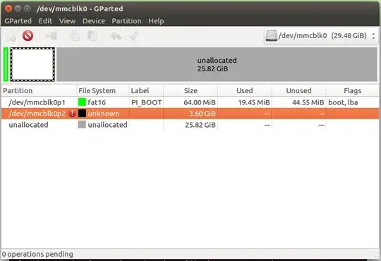

Viewing the SD card in GParted shows the following:
Which shows a damaged (but existing) second partition.

What you see is just the Boot-Partition of your Pi. It is FAT32 and therefore can be read by your phone. The Root-Partition (with all your data) is of type Ext4. You don't seem to have mounted it or your partition table got damaged and is therefore lost. Check your device list if you can find another partition. And check your mounted partitions.
ls /dev
mount
Compare the outputs and see which device is mounted for PI_BOOT and if there is another partition. If the partition is not visible you might try to use ParitionMagic. But this requires higher skills.

Ok, so turns out the Android install files were a red-herring (as some users noted), and this was actually a relatively simple operation.
What I did was use TeskDisk to find the missing data partition. This is done by using the analyse function. Once I had the lost partition I was able to explore the structure and retrieve the specific files I needed.
