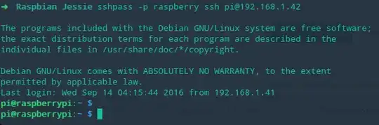

You can use the sshpass utility to login to the raspberry pi.
  • You can install the sshpass using $sudo apt-get install sshpass
  • Then you can add the following line to your script for automated login to raspberry pi sshpass -p "password" ssh username@hostname
  • For example - sshpass -p raspberry ssh pi@192.168.1.1
Sample Screenshot
Hope it helps. Happy Coding Cheers!!
