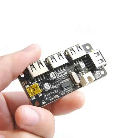

You can get a USB hub that stacks in the same footprint as your Pi and this model even alllows you to maintain access to the GPIO pins. enter image description here
Note these come in two models, one for the original Pi Zero and one for the Pi Zero with camera connector.
