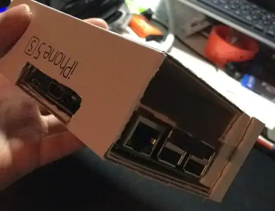

EDIT: made a quick case with an iphone box which is pretty solid, so i managed to mount the pi board into the box with screws, its pretty tight now lol.
