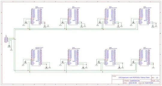

Here this is correct wring for Daisy chain: I/O Expander using MCP23017 Daisy Chain
