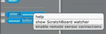

For the controlling of LEDs and such through the GPIO, check out ScratchGPIO. Scratch itself has network broadcasting capabilities out of the box, through a feature called Remote Sensor Connections. All you need to do is right-click on the () Sensor Value block in the Sensing section to enable this feature in your program.
Once enabled, your Scratch program starts sending all Broadcast messages and any change in variable value onto your Local Area Network on port 42001. You can send messages to this port using the Remote Sensor Protocol. From experience I can tell you that implementing this is not difficult and easily achievable by someone with moderate programming skills.
