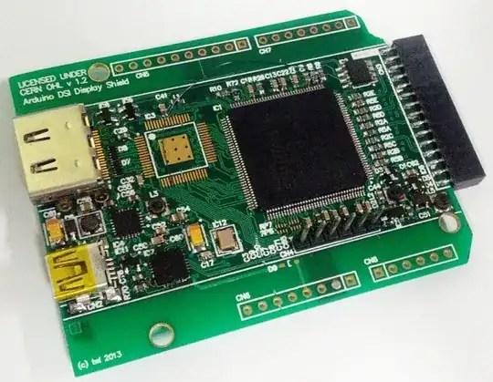

From Using cell phone screens with any HDMI interface, there is a video controller, made from an Arduino DSI Display Shield with a programmable FPGA (Xilinx Spartan-6-SLX9), that bridges the iPhone4 display interface to DSI interface.
HDMI to DSI interface
