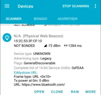

If you want an even quicker test. Then you can create an Eddystone URL beacon that you will not be able to connect to, but will show up as an entry in nRF Connect:
This will create the beacon displaying a URL of https://www.bluetooth.com/
On the Raspberry Pi:
sudo btmgmt add-adv -u feaa -d 1016aafe100001626c7565746f6f746800 -g 1
Which will show something like this on the Phone:
nRF Connect entry for beacon
