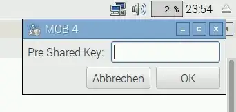

Follow https://www.raspberrypi.org/documentation/configuration/wireless/ or just these pictures.
Click on this button in the upper right corner.
Select your network.
Enter the correct passphrase.
After some seconds you're done. On the next boot you will be connected automatically.
Also check what changes were made to /etc/wpa_supplicant/wpa_supplicant.conf.
