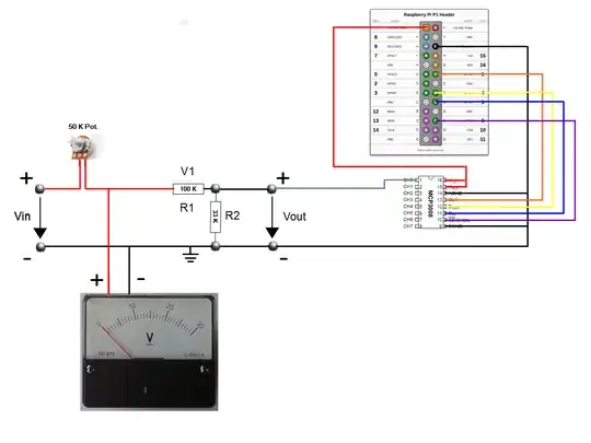

I'm afraid I only have two partial solutions - you'll need to do some legwork to combine the two for both current and voltage sensing.
There's a decent looking tutorial on monitoring the voltage of a 12V battery here, on lediouris.net. Note that it was written in 2014, and the Pi used had only a 26 pin GPIO header. If you're using a later model Pi with a 40 pin GPIO header you'll need to double check the pin allocations. He used a simple voltage divider to get the 12V down to something usable by the MCP3008/Pi, and wrote some java scripts (available here on Github) to read the values. You can see from the diagram below that all of the grounds in the circuit have been tied together.
Battery voltage monitoring circuit
