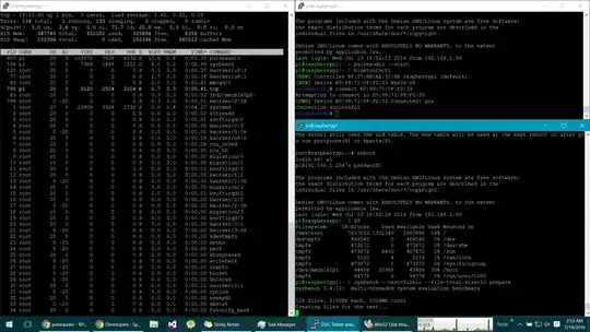

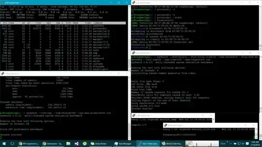

Okay, I've done some tests.
  1. Setup:
    • Pi 3 without a heatsink, 1A power supply (artificial starvation, on purpose)
    • Fresh install of Raspbian Jessie Lite (downloaded a few minutes ago as of writing)
    • Samsung Galaxy S6 Duos
    • VLC player for Andorid
    • 320kbps HD copy of Tremor by Martin Garrix
    • 320kbps HD full copy of Tomorrowland 2014 @ Belgium (57min:11sec)
    • Modified version of this setup: https://raspberrypi.stackexchange.com/a/48055/24224
    • sysbench --test=fileio --num-threads=8 --file-total-size=1G --file-test-mode=rndrw --init-rng=on --max-time=300 --max-requests=0 run
    • sysbench --test=cpu --num-threads=64 --cpu-max-prime=20000 run
  2. Tests (while playing music):
    • Phone right on top of Pi
    • Phone ~1 meter away
    • Phone in kitchen (~5 meters away behind 2 thick concrete walls)
    • Phone inside cookie tin with sewing supplies ~1 meter away
    • Stress test CPU and File IO, 72 threads total
Findings:
  1. Connection very stable in all tests above
  2. pulseaudio at 5%-10% CPU usage according to top
  3. Sound quality 7/10. Perfect when listening at medium-high volume but slight/soft static noise when playing low-volume audio.
Conclusion: Either your device is causing it (very likely) or your Pi is defective (very unlikely).
Recommendations on what you should do:
  1. Check your device. Maybe it's causing issues, especially if it's Android
    • It's very possible that your phone CPU is throttling down, especially when screen-off
    • It's also very possible that your music player app gets killed, especially when screen-off
    • Source: Experience, and I'm also an Android developer.
  2. Try borrowing another phone. Test using that.
  3. Try to find and borrow another Pi 3. Maybe your Pi is defective.
  4. Do NOT fiddle with any pulseaudio settings (/etc/pulse/daemon.conf).
    • Set resample-method = trivial and that's it. Don't touch anything else.
Screenshots (since what stress test goes by without screenshots):
Preparation: enter image description here
Hammer time: enter image description here
Post-trauma: enter image description here
Aloha
