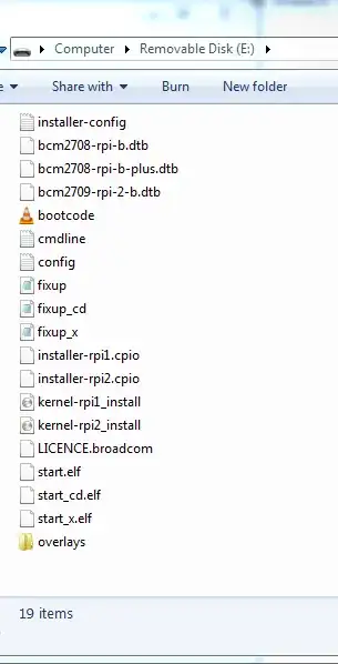

I have reformatted my 64GB SD disk to FAT32 and copied the files as instructed (using Windows7 and Macroit Partition Manager):
SD card setup for EthEmbedded
Link: http://ethembedded.com/wp-content/uploads/2015/06/ua-netinst-sd-card-list.png
When I power up the Pi (3 Model B V1.2), the power LED comes on but nothing else happens.
I get no signal to the monitor.
What steps should I take to debug this?

My initial thoughts are that the FAT32 formatting is somehow incorrect. Windows indicates that the card is FAT32 formatted (RightClick->Properties). Is this enough to confirm that the format is correct?

The problem was that the SD Card was not correctly formatted to FAT32. The Window7 "properties" dialogue box did show it as FAT 32.
I changed formatting tools and managed to get it working - although not completely.
