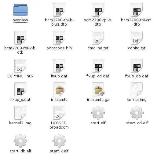

About the image
Actually there's two partitions of the image file pi2-16gb.img.
/boot/ from /dev/mmcblk0p1 and / from /dev/mmcblk0p2 . But the /dev/mmcblk0p2 is encrypted by LUKS encryption.
the kernel.img is derived from the un-encrypted partition /dev/mmcblk0p1
All the files in the partition /dev/mmcblk0p1 (will be mounted as /boot/ are in this picture.
And I think the file cmdline.txt and the file config.txt may be helpful.

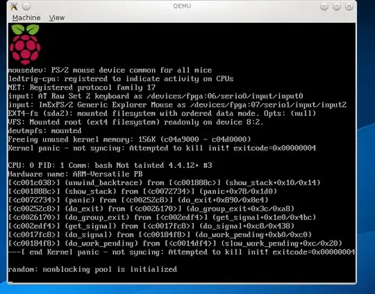

I started the emulator successfully but with an error...
/usr/local/src/qemu-2.6.0/bin/debug/native/arm-softmmu/qemu-system-arm \
-kernel /path/to/kernel-qemu-4.4.11-jessie \
-m 256 \
-cpu arm1176 \
-M versatilepb \
-no-reboot \
-serial stdio \
-hda /media/alex/F049-1FB6/2016-05-27-raspbian-jessie.img \
-append "dwc_otg.lpm_enable=0 root=/dev/sda2 rootfstype=ext4 elevator=deadline fsck.repair=yes rootwait init=/bin/bash" \
The driver can be mounted. Here I tested it with a latest rasbian image 2016-05-27-raspbian-jessie.img
The qemu kernel I used is from :
github(dot)com/dhruvvyas90/qemu-rpi-kernel
But I had a kernel panic...
Here's the error in detail.
debug error kernel panic
