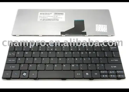

I have an old laptop keyboard like the one shown below: old laptop keyboard
It has a 24-wire flat cable coming out of the back. Would it be possible to use this as a keyboard for the Pi (I assume with some microcontroller in between)?

There is no easy or simple way to achieve what you ask. The simplest answer is just ignore this keyboard and get a USB one.
However, if you really want to do it, it's a DIY job through and through. Your solution will be custom to this keyboard and may or may not be easily adapted to accommodate keyboards from other manufacturers.
Laptop keyboard connectors are not standard. They vary across manufacturers. Typically, they also lack any electronics to process the keypresses and convert them into simpler data messages, e.g. key codes or button codes etc.
Therefore, first you need to figure out what happens each time you press a key, i.e. which electrical signals get activated (get shorted together).

I have few laptop keyboards and I really want to use them... So what I can see those with 24 wires are keyboards without numeric pad while keyboards with numeric pads have 26 wires.
I have torn down one broken keyboard to see how it is made. From what I have seen there are two sheets of foil with paths and connection/button points divided with one foil as a separator. Each wire is allocated to few buttons on one sheet and connects to the second sheet and other wire. I have checked the number of available combinations https://www.hackmath.net/en/calculator/combinations-and-permutations?n=24&k=2&order=0&repeat=0 look's like we have 276 possible combinations.
Because there are many keyboards and they have different combinations best way is to make a small program that asks you to press a specific button and record which wire-wire combination is associated with that button.
Since Rpi has only 17GPIO as Vassilis mentioned it will be hard to do it because you need something in between, but there is Arduino (Mega = 54 IO)and it can help at least to decode button/wire pair combination. I need to look on laptop boards what ic are used as the controller to see if we can use it, is it programmable etc.
Anyway, it is possible and probably not that hard but of course normal people would just buy a USB keyboard.
