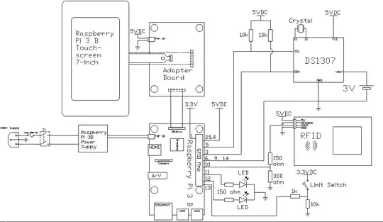

My schematic with all connections

Besides changing changing the port from /dev/ttyAMA0 to /dev/ttyS0 because the default device node for the Pi 3 is different.
I figured out what my problem was and it lies within the config.txt file, I added the line enable_uart=1, this will enable the device itself. Tested it and it works 100% for me.
