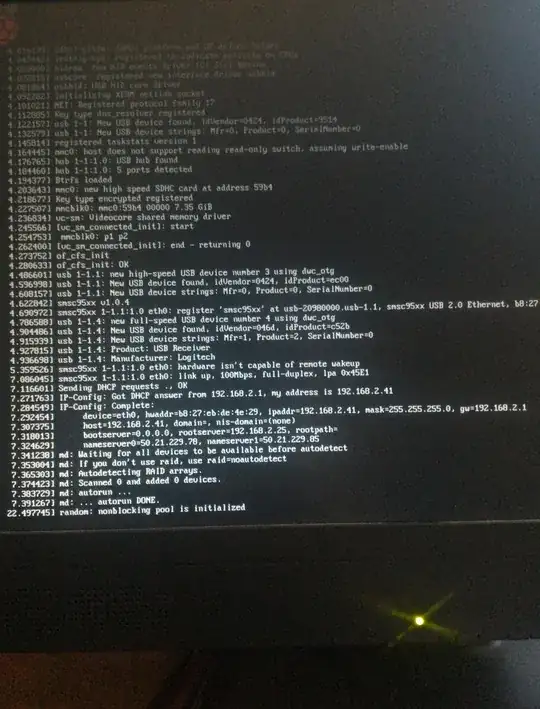

UPDATE (06-06-2016) -- took a picture of the boot logs with loglevel set to 7. The line [ 7.318013 ] ... rootpath= is odd, as rootpath should be set, according to the kernel line.
7.318013 rootpath is not set
