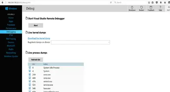

You will first need to make sure the remote debuggin is enabled in the dashboard.
Since you have already deployed the app to the Rasbperry Pi Windows IoT via Visual Studio you can simply select Debug | Start Debugging and any breakpoints will be hit.
