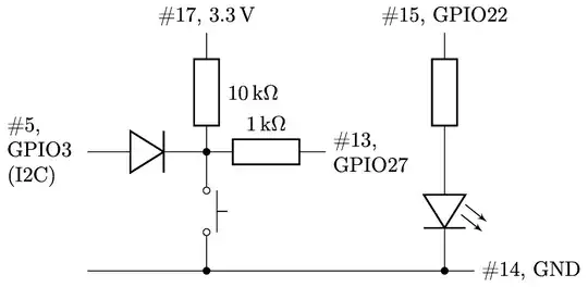

I am able to create a shutdown (and reboot) button for a plain Raspi harnassing the fact, that shorting Pin 5 to GND will reboot the Pi if shutdown.
However, when adding the HifiBerry HAT things become more complicated, as Pin 5 is used for I2C and as stated by HiFiBerry, some other GPIO-Pins are used as well.
Now to my question: Will the following curcuit work with the Amp+ HAT?
In the shutdown script I would be monitoring Pin 13 for LOW state and send sudo shutdown -h now.

Will currents drawn from Pin 5 influence the function of the HAT in this setting?

If #5-GPIO3 truly is being used for I2C by the HiFiBerry, you should be OK, at least from a circuit damage perspective, since I2C IO's only sink, which is what your push-button would be doing when pressed. There is, however, a chance of odd behavior due to the fact you'd be asserting an unexpected low on that I2C line.
Since the RPi I2C ports are pulled up on the RPi PCB, you may not need the 10K pull-up. Also, it wasn't clear what it was intended to do, but there may be an opportunity to remove the diode as well.
