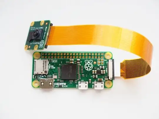

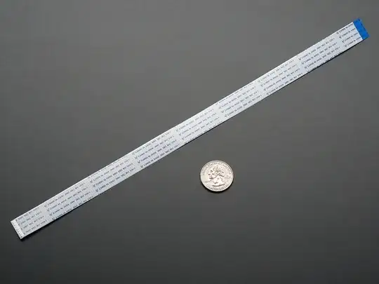

The RPi camera uses a cable that looks nearly identical to a flat flex cable.
enter image description here The regular RPi Camera connector. enter image description here The Pi Zero adapted version.
I have seen videos of people folding/creasing these types of cables. (Source) But I do not know if this is okay to do with the RPi Camera's cable. Could this do harm to the cable and cause it to not work or be unreliable?
The reason I need to fold/crease it is because I have a project in which a Pi Zero is almost touching the walls of it's casing, so the cable only has about 0.5cm of space between the Pi and the wall.

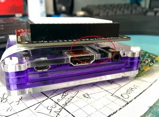

We often get this sort of question at picademy when people want to use a camera module with something like an Explorer HAT (which doesn't have a hole for the camera's ribbon cable, so it winds up getting very-nearly-folded as it exits the CSI port). The answer is it usually works fine.
Here's an image of the sort of thing I mean. This is a V2 camera module's cable getting squished under a RasPiO Pro HAT (but still working happily):
folded camera cable
However, how many times you can fold it back and forth before you break it ... well, that's down to your luck! In other words, with your situation (a case forcing the cable to make some uncomfortable turns), I wouldn't expect there's an issue as I assume the cable won't be repeatedly folded or bent, but if you're continually installing and uninstalling the camera, you might want to buy some spare cables!
