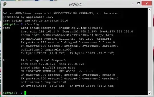

i have used "sudo nano /etc/dhcpcd.conf" and added static address, after reboot the raspberry pi shows static address in ifconfig and i can also access it using putty, but it is not able to connect to the internet. i have checked the router and this device does not show up. I am sure there is nothing wrong with the router or cable as i was able to access internet before setting the static ip address.
ifconfig before setting static ipifconfig
lines i have typed..

You have not provided sufficient information to give a definitive answer. You should post what ifconfig shows BEFORE attempting to set static (or get this form another computer).
There is at least one obvious error; an incomplete CIDR address. See How do I set up networking/WiFi/Static IP
Address should be
static ip_address=192.168.1.150/24
