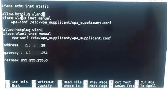

I want to set up the networks on my raspberry, I tried to do it the static way:
I opened a terminal on the pi, wrote:
what I did
That is to say, I wrote static instead of what was written before (which was not dhcp if remember). And wrote down address, gateway and netmask only changing the two last digits of the adress from the one I had written on my computer.
Yet, when I try to ping the given adress I receive no response...

The answer was found at pihw.wordpress.com, all I had to do was
sudo ifconfig eth0 the.add.ress.togive
If you have better answer I would accept then, else I would answer my own question
If you want to do this in /etc/network/interfaces you need to add the information immediately after the eth0 declaration, e.g.
iface eth0 inet static
address 192.168.0.29
gateway 192.168.0.254
netmask 255.255.255.0

There are many ways of allocating static IP addresses. You don't mention which OS you are using.
See How do I set up networking/WiFi/Static IP for a tutorial for latest Raspbian.
you can either add denyinterfaces eth0 to /etc/dhcpcd.conf and configure it with /etc/network/interfaces
or
#Static IP Block interface eth0 static ip_address=192.168.0.200/24 static routers=192.168.0.1 static domain_name_servers=192.168.0.1
http://sizious.com/2015/08/28/setting-a-static-ip-on-raspberry-pi-on-raspbian-20150505/
