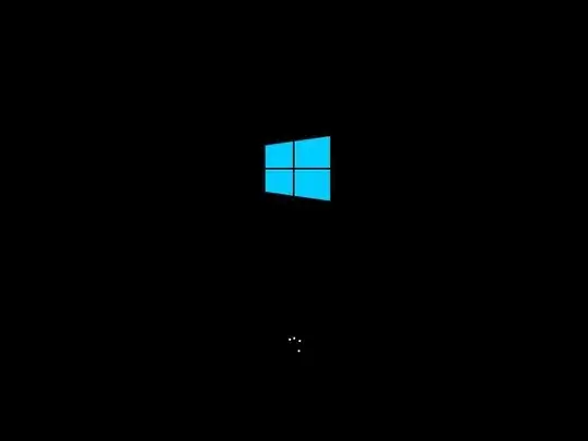

When I try to boot my Raspberry Pi 3 with Windows IoT Core it remains on this screen forever:
it's stuck booting
I've tried 2 different builds now, 14322 and 14328. Also I tried via noobs and via the IoT dashboard from Microsoft. The device is connected to the internet via an ethernet cable. The OS is installed on a 32gb class 10 samsung evo micro sd card. Is this a known issue? How do I fix this?

I had this problem too, it never got past that boot screen. It turned out it was a power supply problem. Pi 3 requires 2 A, and I had a 1.5 A micro USB adapter. When I switched to a 2 A adapter it worked as expected.

I had very similar problems - I found the length of time for the first boot increases with the size of the card (so I'd expect that a 32GB card could be 15 minutes or more).

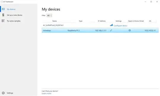

You mention you've got it connected on ethernet - look at the list of devices on your Windows IoT Dashboard. If you can see it there then you know it's working at least. I sometimes find that the first boot finishes with an error - after 15 minutes I got a CRITICAL_PROCESS_DIED error, but it automatically rebooted after that, and after a shorter period of time it took me to the Windows IoT set up screen.
Windows IoT Dashboard image showing Raspberry Pi 3 on the network
I've posted about my experiences at the link below, but hopefully the information above is helpful to you given where you are in the installation process. https://jeremylindsayni.wordpress.com/2016/05/02/windows-10-iot-and-the-raspberry-pi-3-installation-failure-and-eventually-success/

In my case it was a USB keyboard (dell keyboard with smart-card reader). Try connecting your peripheral devices after booting Win10 IoT.

I got this problem as well, once. I was unable to open the Device Portal. Found out that faulty USB Power supply was the culprit.
