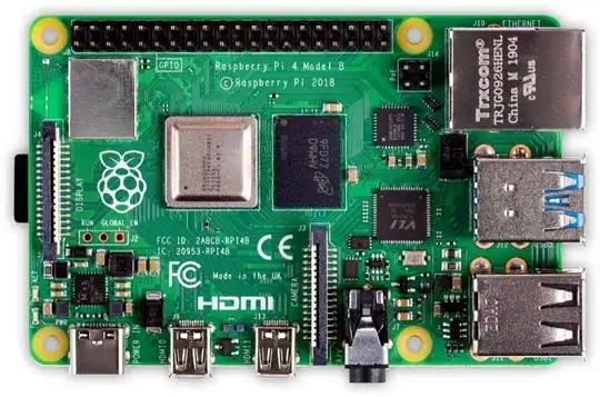

Finally as of June 2019, the Raspberry Pi 4 Model B had been released:
RPi 4
(source: raspberrypi.org)
It comes with 2x USB 3.0, 2x USB 2.0, 2x 4K-Display support over Micro-HDMI, Gigabit Ethernet and up to 4 GB of RAM. This makes it possible to use it as a full desktop replacement if you want to. But it also powers your peripherals with USB 3 speed, as you requested.
The price seems to start from $35.
