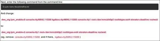

Tonight, I was adding a GPS module to my RPi3 by following a tutorial from Adafruit, and now my RPi3 is not booting up.
This is the last change I did before doing a reboot via sudo shutdown -r: Changes to /boot/cmdline.txt before rebooting I changed it to: dwc_otg.lpm_enable=0 console=tty1 root=/dev/mmcblk0p2 rootfstype=ext4 elevator=deadline rootwait

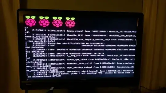

I connected an HDMI cable to it and this is the error message I see: Boot Error
Kernel Panic - not syncing: VFS: Unable to mount root fs on unknown block(179, 2)

VFS Unable to mount root fs on unknown-block (179,2) is the problem you need to fix. It means that you have a broken file system at hand, which could be just the file system or even a broken SD card.
