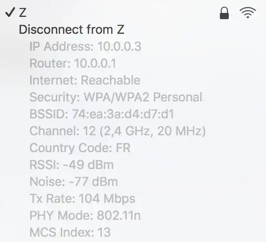

This is my wifi info, seen from OSX. It is not a hidden network.

There is a bug in current software/firmware which prevents the on-board WiFi from running on Channel 12.
Channel 12 & 13 are not available in all countries. There is a WiFi Country setting in raspi-config but unfortunately it does not work with the current firmware.
Some users have reported success, but this may be related to those using the latest pre-release firmware.
EDIT Even after upgrading to 4.4.9 I still had only channels 1-11.
Installing sudo apt-get install crda enabled 12, 13
