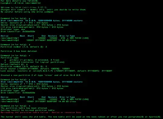

I want to expand my filesystem, so I tried to follow this tutorial to expand it, but it did not work.
I had to fix it. To expand the file system of my SD-card of 16 Gb, I had to install gparted and move the partition to the entire size of my SD.
