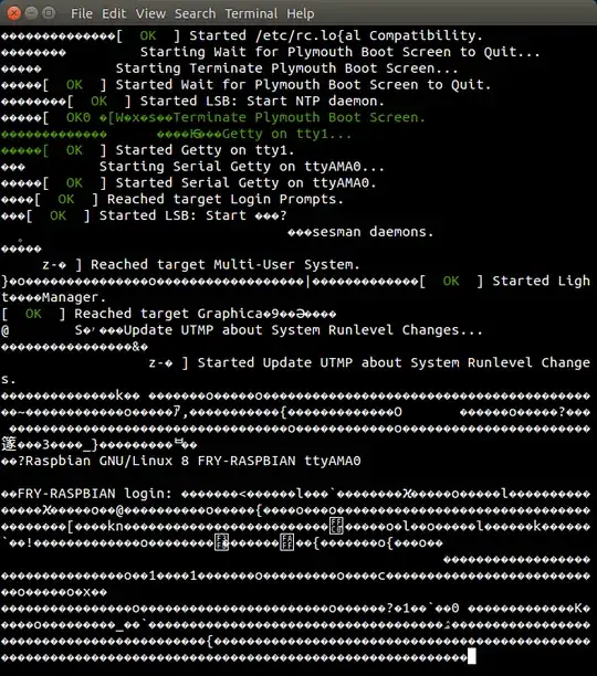

From the Ubuntu computer, I launch the screen utility to see whatever the Pi will communicate through serial.
phodor@UBUNTU: sudo screen /dev/ttyUSB0 115200
I then plug in the Pi power supply. I can clearly see the Pi's boot-up information flowing in the terminal. Yet, many weird characters show up all over the place. Once I get to the "login" line, the terminal is waiting for my username for the pi, but these weird characters keep flowing into the screen and I am never able to type in the user name.
