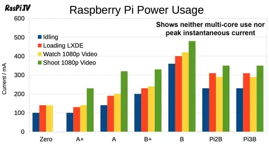

The Pi 3, while idling, consumes about 220 mA. Under loads, it is known to reach up to 1 A, and with USB devices plugged in, it can reach 2.5 A. There is no on board current sensor, so this is only a tool for a good estimate.

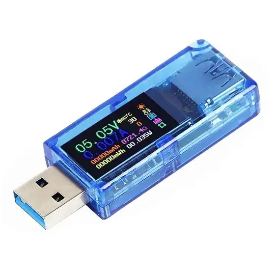

There are some cheap USB "power meters" available (I know you said no external hardware, but) on Aliexpress (or anywhere that sells Raspi and Arduino stuff really). They will show you voltage, current and power.
