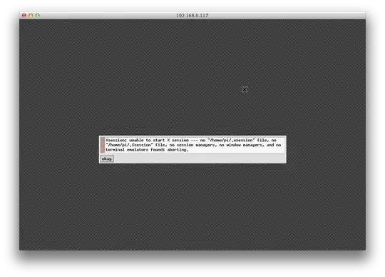

I read about RDP on Raspbian, but how about the Raspbmc desktop; is there a way to do a remotely connect into it?

Seems like the real answer lies in the Raspbmc FAQ:
Q: Can I run a VNC server on Raspbmc?
A: No. VNC relies on the X11 window system, but Raspbmc’s XBMC implementation is rendered in the framebuffer only. Thus VNC cannot be used as there is no X-session available for connection.
RDP, just like VNC, relies on the X11 window system—the same limitation applies:
xRDP on Raspbmc: unable to starts X session
