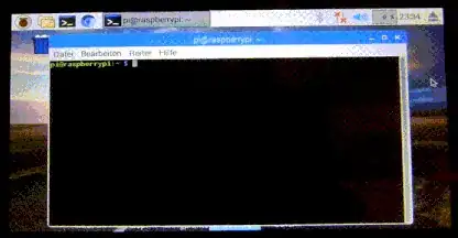

I've made a Python package for this: github.com/linusg/rpi-backlight. Now you don't need to implement this yourself anymore.
Example
(GIF is outdated because API was changed quite a bit in v2, sorry... Below example is correct )
Works basically like the above, example:
>>> from rpi_backlight import Backlight
>>> backlight = Backlight()
>>> backlight.brightness
100
>>> backlight.brightness = 50
50
>>> with backlight.fade(duration=1):
...     backlight.brightness = 0
>>> backlight.fade_duration = 0.5
>>> # subsequent `backlight.brightness = x` will fade 500ms
>>> backlight.power
True
>>> backlight.power = False
>>> backlight.power
False
It has a GUI, a CLI and a simple Python API :)
