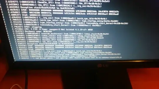

I got hands on my Raspberry Pi 2 Model B in just few months and when i used it soo much the SD card got bent in here and it want to snap apart but when i removed it i was trying to rebend it back with a LG LCD panel monitor it dint still boot i think it was removing the case and it bent in here. So i had is 2 GB SD card wich was one of the worst ones to work with the Pi and only OS can be here is Kodi and OSMC. I was looking online to see how to boot up but it din't work beacuse files are outdated so i gone and writing this post to tell how i can make Pi boot from 8 GB USB stick easly not complicated way? And as well I gone to the research and i think when i unzip the files from Raspbian there was 0.fat i opened it and there been boot files but i dont know where i should put them and i thought that if boot text file that some talked about i think they both should have that set to "root=/dev/sdb" so the SD card and the flash drive should have the same code. Update : @Neckbeard2016 i get this error Error

As far as I know, you still need a card as your primary boot partition. If yours is broken, no USB stick can fix that. Seems you really need a new SD card to get your RPi running again.
Take a look at this: http://jonathanmh.com/boot-raspberry-pi-from-a-usb-stick/
