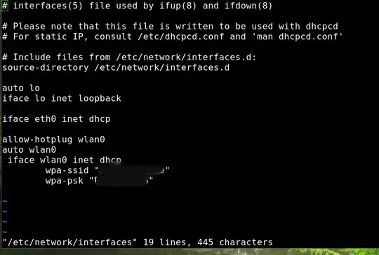

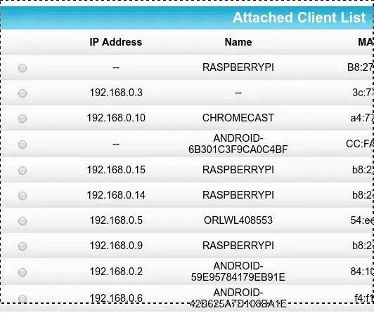

Why does my rpi connect so many times at once to the internet. For the record I have one rpi2 and one rpi3 and they share the same sdcard, I just switch it between them. I tried both the ethernet as the wlan and in both cases it happens. It already caused problems as I was trying to install a program felt like it froze.
Jerome
Because you fiddled with the settings. See the following for how to fix it.
How do I set up networking/WiFi/Static IP
