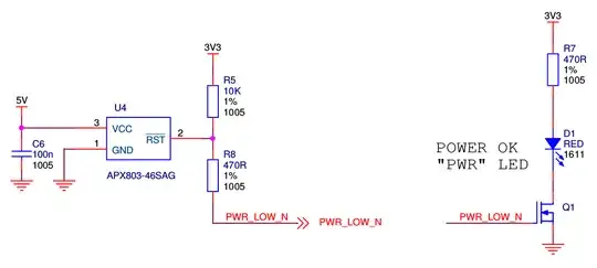

It sounds like the power supply is failing to regulate and dropping out momentarily. The answer below seems to describe a similar scenario and the rpi wiki also mentions that the blinking PWR LED indicates an issue with the power supply.

On model B+ (and presumably also the A+), the circuit has been improved to give a much more reliable warning of poor power quality. The red power LED is wired to an APX803 supervisor[2] which kicks in when the 5V power supply drops below 4.63V[3]. If it does, the LED will blink. Check your connections, cable, and power supply.
From the APX803 supervisor data-sheet:
Microprocessors (μPs) and microcontrollers (μC) have a reset input to ensure that it starts up in a known state. The APX803/D drive the μP’s reset input to prevent code-execution errors during power-up, power-down, or brownout conditions. They assert a reset signal whenever the VCC supply voltage declines below a preset threshold and keep it asserted for a fixed period of time after VCC has risen above the reset threshold
If the data-sheet for the model B+ is correct, the APX803 is hooked up to the red PWR LED as the wiki states. I can't account for the blinking (could it be caused by C6? Is it actually the raw input power drops you're seeing? Is it a feature of the APX803?) but it certainly shows that the APX803 can make or break the ground connection of D1 (red LED) via Q1 (depletion-mode n-channel MOSFET):
