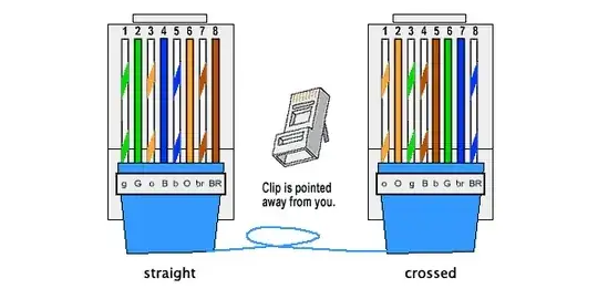

This is an addition to Milliways answer. For some reason I suspect you are trying to connect the pi directly to your PC using the ethernet cable, I want to highlight that unlike Ethernet cables you use to connect through a router or switch , you will need a crossover Ethernet cable. This shows how to modify the cable to make it a crossover. enter image description here
