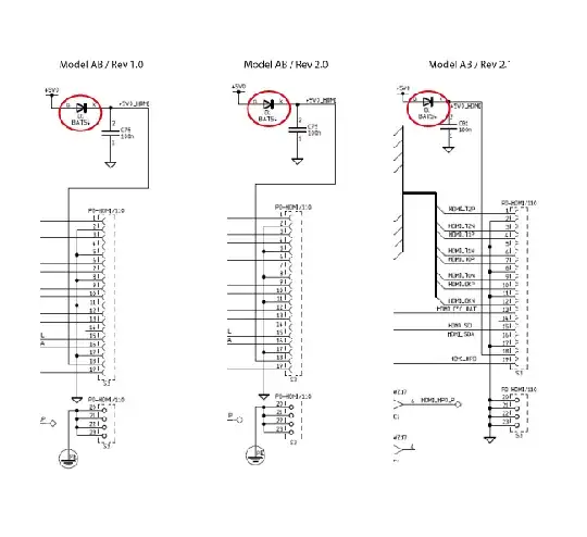

The schematics for various Pis are provided by the RPi Foundation here.
The schematics for all revisions (1.0, 2.0 and 2.1) of the Raspberry Pi 1 Model A and B indicate that the HDMI power circuitry on each model is identical:
RPi Model AB Revs. 1.0/2.0/2.1 / HDMI power circuitry
Each revision incorporates a BAT54 diode (D1) which is widely documented (see elinux.org here and here, raspberrypi.org/forums here and here, github.com/raspberrypi) to max out at 200mA.

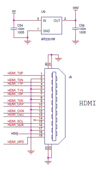

The schematic for the Pi B+ shows that this arrangement was changed to incorporate an AP23331W 0.2A single channel current-limited load switch:
RPi Model B+ V1.2 / HDMI power circuitry
Finally, the schematic for the Pi 3B shows that it uses yet another component, an RT9741CGV 100mΩ, 0.7A High-Side Power Switch:
RPi Model 3B V1.2 / HDMI power circuitry
It looks to me as if the original model boards and the Pi B+ will allow up to 200mA through the HDMI socket. The Pi 3 should allow up to 700mA through the HDMI socket. As far as I'm aware there are no schematics available for the Pi 2 or the Pi Zero, which leaves them in uncertain territory.

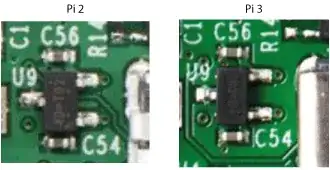

UPDATE
A very close look at a couple of product shots suggests that the Pi 2 uses the same RT9741CGV component as the Pi 3:
Pi 2/3 HDMI power circuitry comparison
You can just about make out the '4D=***' marking detailed in the datasheet. That suggests that the Pi 2 should also be capable of supplying 700mA through its HDMI socket.

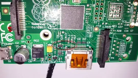

A quick test on HDMI pin 18 shows some interesting results:
On the Pi1A, there's a 0.14v difference between GPIO pin 2 (4.98v) and HDMI pin 18 (4.84v) which I think is evidence that HDMI pin 18 is not connected directly to the 5v rail. After a quick check, it's connected to D1?
Update: I've re-done the test on another Pi1A and it's consistent with above.
On the other hand, testing the same pins on the Pi 3 gives no difference (both 4.96v) in voltage whatsoever, giving the impression that it's directly connected to the 5v rail. I also can't follow the PCB trace.
