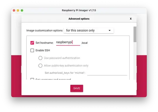

In the 'modern' Raspberry Pi Imager using the cog wheel in the first screen allows you to set some presets including the hostname but also wifi configuration, default user name, whether SSH is enabled or not, very useful!
Raspberry Pi Imager > Advanced Options
If you select a new hostname, this will create a file on the 'bootfs' partition of your SD card after writing. So if you do not want to use the Raspberry Pi Imager, you can also do this manually. Create a file called firstrun.sh and add this, for changing the hostname to jackfruit.local:
