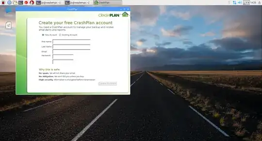

To make up an RPi-compatible backup service, I can advise you to install CrashPlan on Raspberry Pi. For that (as CrashPlan works only on x86 Linux) you need to use some Linux environment emulator to be set up and switched on as a first step. Below, I'm gonna get you a tutorial, with ExaGear Desktop emulator, as an example. On your side, you can use any type of a an emulator ;)
Set up ExaGear Desktop
  1. Put ExaGear Desktop archive with installation packages and ExaGear Desktop license key in the same folder. Open Terminal (command line), move to this folder and unpack the archive using the following command: $ tar -xvzpf exagear-desktop-rpi*.tar.gz
  2. Install and activate ExaGear by running install-exagear.sh script: $ sudo ./install-exagear.sh Launch guest x86 system
  3. Enter the guest x86 system using the following command: $ exagear Starting the shell in the guest image /opt/exagear/images/debian-8 Check that you’re in x86 environment by running the ‘arch’ command: $ arch i686
  4. It is recommended to update apt-get repositories on the first launch of the guest system: $ sudo apt-get update
Install CrashPlan
  1. Remember! It is super important for you to download specific libraries to enable CrashPlan browser operations. Simply input: $ sudo apt-get install lxrandr libgtk2.0-0 libXtst6 cpio
  2. Now, you have to get back to the folder, where CrashPlan archive has been previously downloaded. Usually, it is the “Download” folder if you’re using a Raspberry Pi model. In case of Raspberry Pi, the path to the folder that you should input into the command line is the following: $ cd /home/pi/Downloads
  3. As soon as you are inside this directory, unpack the files: $ tar -xvzpf CrashPlan_4.8.2_Linux.tgz
  4. Install CrashPlan inside the x86 guest system. NOTE! Directory where we are operating in this tutorial is optional and valid only for Raspberry Pi hardware! $ cd /home/pi/Downloads/crashplan-install $ sudo ./install.sh
The installation manager will offer you to install a number of directories. Agree with all default options by pressing Enter to all the queries. Configure CrashPlan autostart
  1. To make CrashPlan service autostart after system reboot type the following commands: $ sudo service crashplan start 2>/dev/null $ sudo update-rc.d crashplan enable
Run CrashPlan
  1. To start CrashPlan type the following command: $ /usr/local/bin/CrashPlanDesktop Otherwise you can run CrashPlan from the Start menu:
You’ll see a browser window with the empty fields to fill out and start up your account. Just go ahead and follow the form guide. After completing this registration you’ll start the backing up. So, enjoy![crashplan on raspberry pi]1
