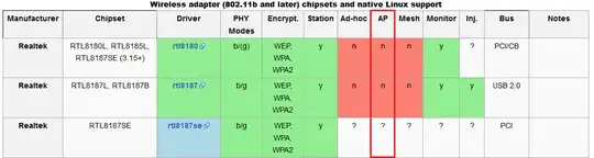

goldilocks is right, your chipset is not supported. If you decide to obtain a new wireless adapter, I invite you to check this wiki page listing essential options provided by various WIFI chipsets. The capability required by hostapd is called AP (short for Access Point). For example, take a look at your current chipset, RTL8187:
Personally, I use adapters with Ralink chipset, as you can see almost all chipsets from them support AP mode.
