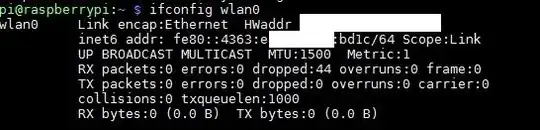

So as it stands now, this is what I get when I check the wlan0 setup. As you can tell, it does not have an IP address, but a mixture of letters and numbers.
current setup
At this point I'm not really sure what to try next. Suggestions?
