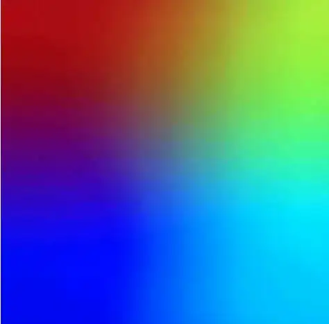

I have spent the past couple of months developing software on my RPi2 and I would like to now run this on my RPi3 to take advantage of the higher performance. The software I have written relies on many other software packages and dependencies that I have all sorted out and working on the RPi2.
So far I have tried:
  1. I tried to take the working SD card from my RPi2 and place it in my RPi3, it did not work. It locks up at the rainbow start-up screen (shown below).

    After successfully updating and upgrading I tried to place the SD card into the RPi3. STILL locks up at the rainbow start-up screen.

Yes it is a NOOBS install.
In addition to updating the OS image you also have to update the kernel and firmware used by noobs. Otherwise your system will not boot on the new hardware.
I haven't tested this for the pi3 yet but I think you need to download the latest noobs lite and copy the files "bootcode.bin", "recovery.elf", "recovery.img" and "recovery7.img" anong with any ".dtb" and ".dtbo" files to the recovery partition (the first fat patition) on the SD card.
Note: some older advice advises people to copy all files except recovery.cmdline . Unfortunately doing this will break things if the existing noobs install used the old partition structure.

You have done most of the work already. Before putting it in your RPi 3, you also need to run apt-get dist-upgrade.
The dist-upgrade is what actually upgrades the firmware.

I don't think it is possible to pull this off. My suggestion would be to back up all of your user directory and other files such as modules and configuration files you remember modifying, then flashing the latest build of Raspbian on the OS, then simply retrieving the files and putting them back on the Pi.
