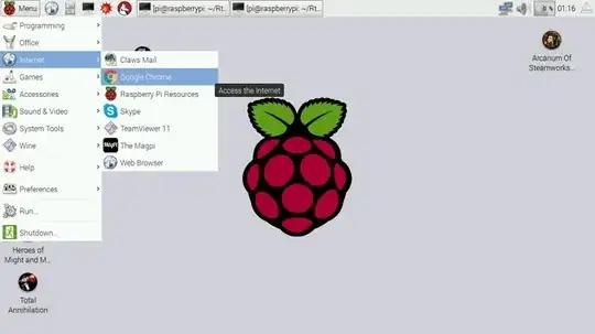

Regardless of what everyone else says it is possible to install google chrome and all other x86 apps on raspberry pi! Here is a simple instruction on how to install and run Google Chrome on your RPi 3 device.

Run Chrome Screenshot of chrome
