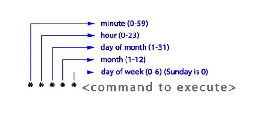

You have to write a cron job to do that task.
  1. Write crontab -e in your terminal to access crontab
  2. Then follow below image to write a cronjob.
In the you have to write source\to\python file.py to execute at a given time.
For more information refer this link.
