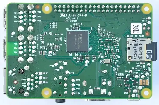

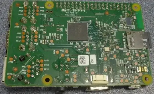

There have been no comments (at least from what I've seen) on the sd card slot of the Pi other than that it is a friction slot (like the Pi Zero), instead of a spring lock. It's safe to assume that the bus is still limited to 20Mb/s. I wouldn't worry about getting a UHS-3 card. The Pi 3's features are listed here.
You can see the spring lock here: (on the Pi 2)
And the friction slot here: (on the Pi 3)
